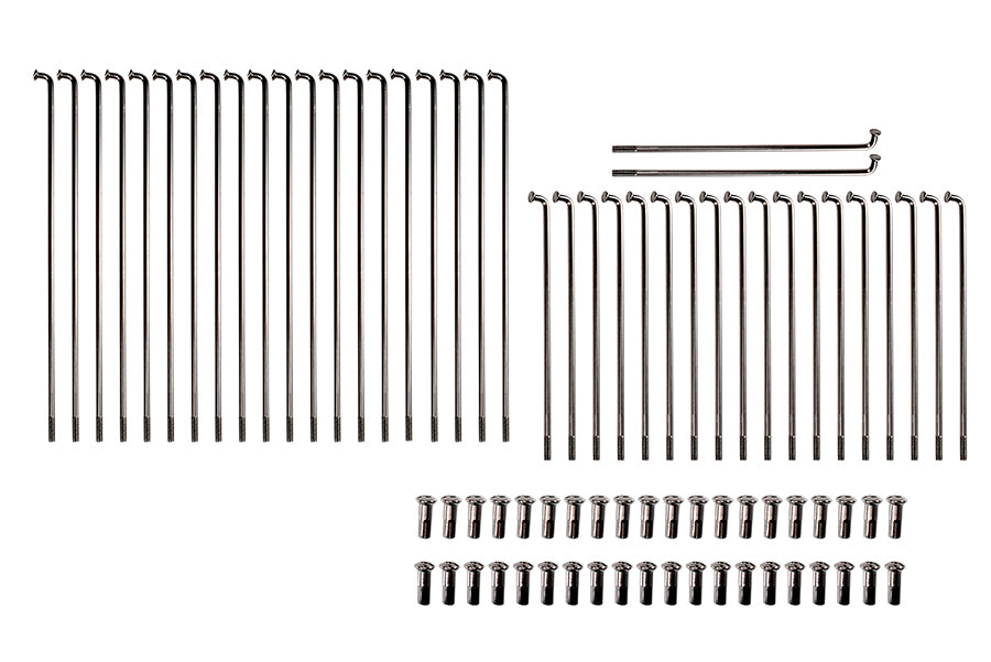

Stainless Steel spoke set for stock OE spoke pattern lacing. Kit includes 40 spoke nipples.
9 gauge diameter single stage spokes feature a natural finish and two sizes 21.5mm and 15.5 mm. Cross four on drum side and two on small hub diameter end. Nipples are stainless steel. *NOTE: We suggest using 22mm long nipples when lacing 45 Front drum wheels. *NOTE: If required longer nipples are available separately.
  • Short Spoke Length: 6 inches
  • Long Spoke Length: 8-3/8 inches
  • Diameter: 3.5mm
  • Nipple Length: 19.50mm
  • Suggested to use with Conventional and Replica 40 Spoke 18inch X 3.15inch Front Wheel Rims.
  • Required to use with 40 Piece Spoke Nipple Set Stainless Steel if longer nipples are needed.
  • Suggested to use with Spoke 40 Piece Stainless Steel Nipple Set.
  • Information for lacing the 18inch 45inch wheel: Drum Side - Top cross 1 spoke head face down. Lower spoke cross 1 spoke head faces up.
  • Spook side - top spoke cross 4 clockwise. Lower spoke cross 4 counter clockwise. 11/16inch offset from drum flange to side of rim.
