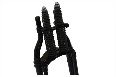

Assembly includes front legs inner and outer springs outside type rockers for 5/8 inch axle with studs and bushings rear leg in black with 7/8 inch neck stem and spring rods with bushings.
Includes front leg inner and outer springs outside type rockers for 5/8 inch axle with studs and bushings rear leg in black with 7/8 inch neck stem and spring rods with bushings. 1 inch tubes on top of the rear legs are tapped 3/4 inch-16 to accept a threaded riser which allows use of a triple tree without ears and builder's choice of post riser set.s Will accept all original style components and accessories for the detailed Replica look. For use with 1936-64 style interchangeable star hub wheels. Top clamp neck races and cone nut are not included. Assembly is a product of 14 separate processes: Tubing Hydraulic Swate Press Investment Casting Forging Flattening Press Robotic Welding Brazing Polish Chrome Paint Spring Winder Machine Shop Drill Shop and Packaging.
  • Neck Stem Size: 7/8 inches
  • Length: 18 inches
  • Rockers Measure: 6-1/2 inches
  • We measure from the top of the rear leg (tube) to the front axle center line.
  • *NOTE: 45inch Spring Fork rockers are mounted to the inside of the fork and utilize a 3/8inch axle. 45inch Servi-Cars 1947-1957 use Big Twin rockers on the outside of the fork.
  • How we measure Spring Forks. NOTE: Measurement is from the triple tree where stem and lower bearing sits to the axle position. This is the effective length as it is the legnth
  • from the lower bearing cup on the frame to axle. Installer can slide a pipe or solid bar thru the bearing cups and measure the length that may be needed for the desired frame
  • height. This Spring Fork assembly accepts a 3/4inch axle for custom applications. As rockers are not offset (as on replica Spring Forks). 1inch stem utilized tapered bearings for
  • ease of installation.
  • *NOTE: UPS may consider this part as packages inchoversizeinch for shipment as compared to the actual weight which will result in higher shipping costs.
