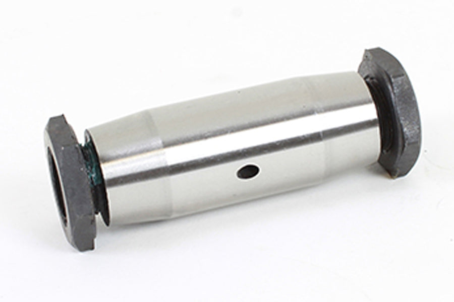

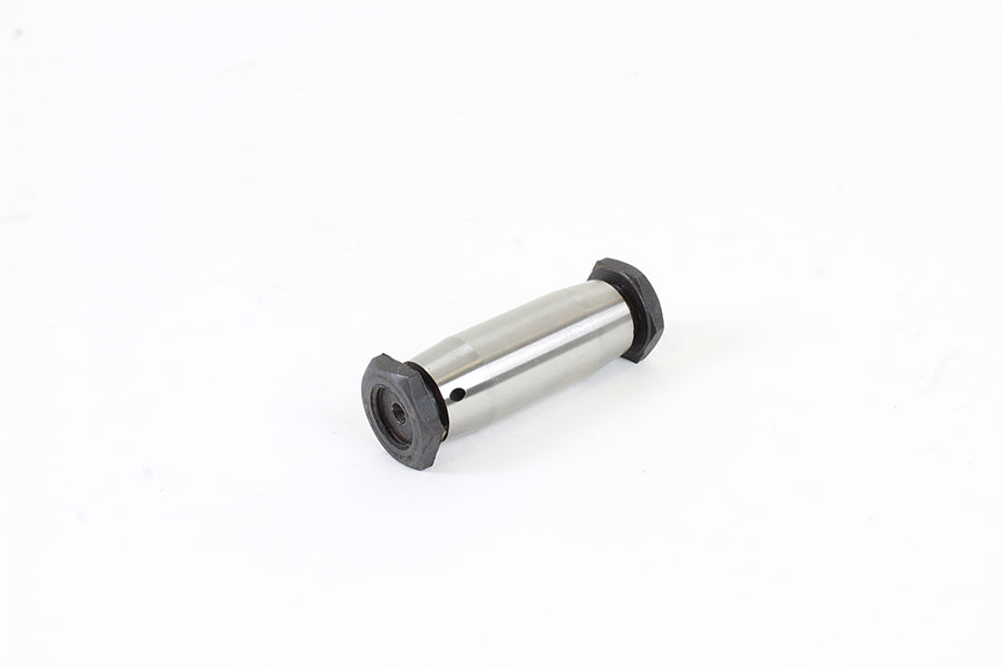

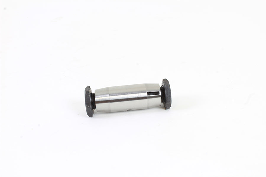

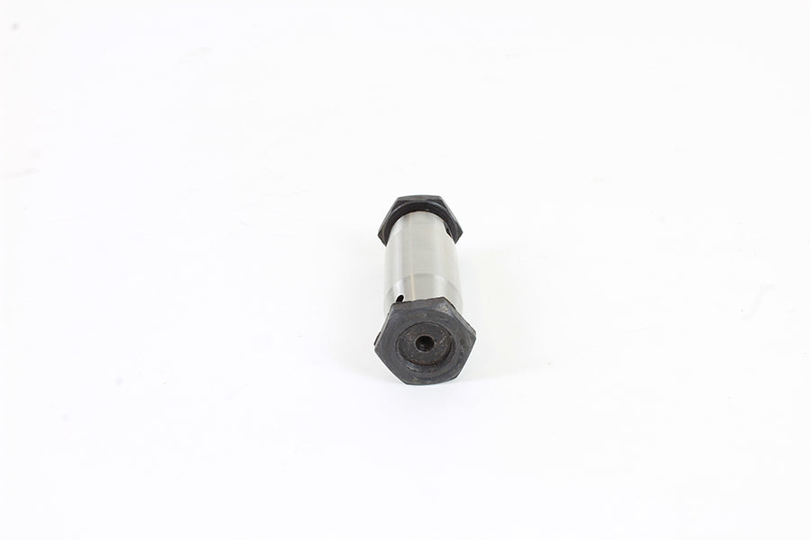

Sifton 1-hole crank pin is made of 8620 steel with a heat treatment depth of.062 inch.
You must align oil feed in flywheels with crank pin. OEM uses two different flywheels so oil feed hole locations may differ this crank pin includes two oiling feed holes to fit both the early and later flywheels. The distance measured from the edge not including threads is 2.505 inch. *NOTE: Must order nut kit separately.
- Diameter:.9960
- *NOTE: Oil holes right side feed hole flywheels are keyed on left side. Center timing to key. Key 12 o'clock oil feed at 8 o'clock.
