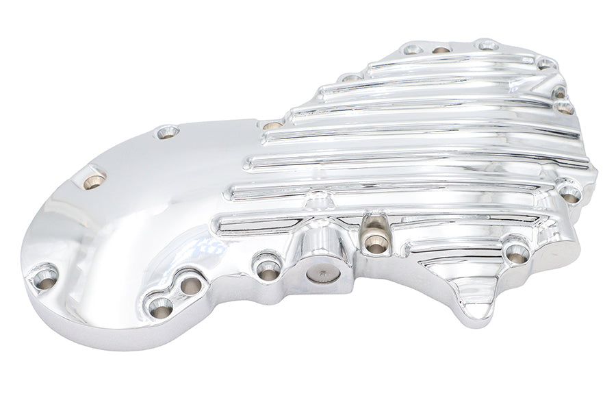

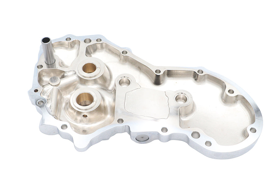

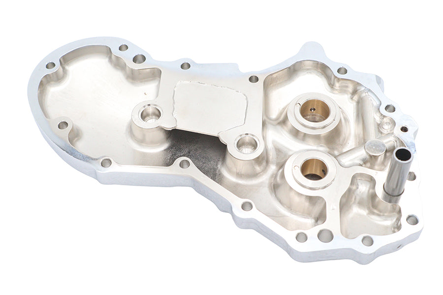

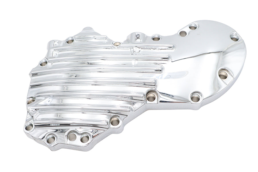

8-Finned Panhead Cam Cover Chrome - V-Twin 10-1631
Panhead 8-finned cam cover features a chrome finish and has a Hubbard welch plug installed as original. Cover includes an early pinion shaft bushing installed.
This cover is exact for 1952 Panheads. Cam cover does not include OHO oil feed hole. *NOTE: This is the Alcoa version. Cam cover bushings must be checked and fitted (reamed) for final assembly. Check end play as well. Make sure oil passages and oil feed holes in bushings are clear. Tapered screw holes may require a deeper counter sink check with screw head before installation. May require some modification for proper fitment. *NOTE: Check oil passage (drilled hole) into bronze bushings either on existing bushings or when replacing bushings. Generator holes for 32E 6 volt 2 brush generators are 1/4 inch on Pre-1957 models and 5/16 inch on 1958-1969 models.
- *NOTE: Final reaming for fit should be completed with cover on the right side case reamed from the left side.
