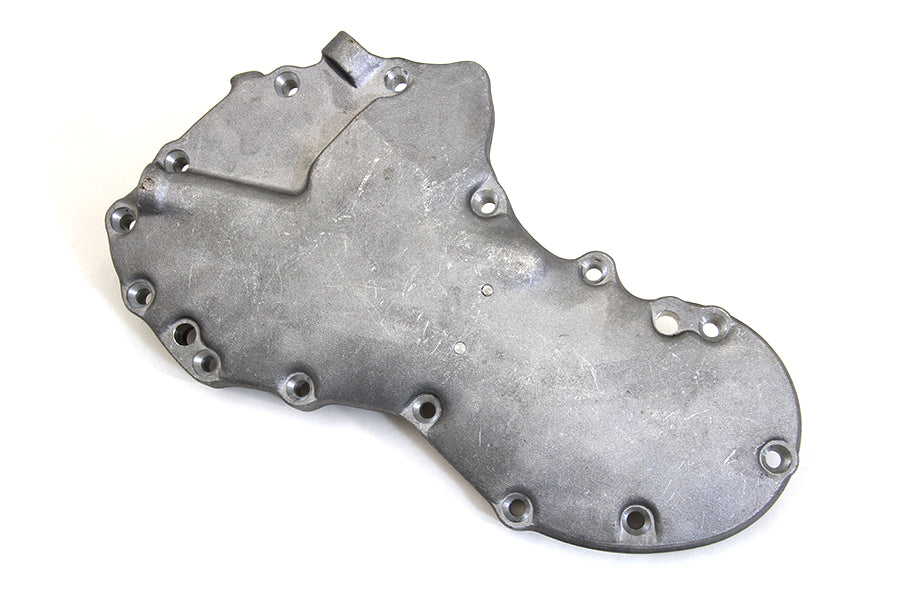

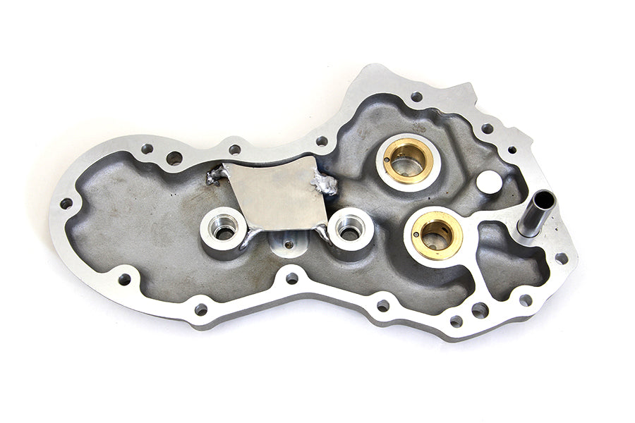

Cast cover is an exact replica of the early 1936 61 inch EL models perhaps for the first 200 units made that year. Cover features natural cast finish as original! Bushings and breather plate are installed. Cam cover bushings must be checked and fitted (reamed) for final assembly. Check end play as well. Make sure oil passages and oil feed holes in bushings are clear. Tapered screws holes may require a deeper counter sink check with screw head before installation. Inside cavity is 1937-1939 type with cast in baffle. Brass rivets show through over breather plate. The outside may be modified with the additional two brass rivets for an authentic Tedd Cycle look! Molded with V-Twin MFG's exclusive tooling. *NOTE: Cover can also be used on 1936-1947 61 inch and 74 inch Knuckleheas models. *NOTE: Check oil passage (drilled hole) into bronze bushings either on existing bushings or when replacing bushings. Generator holes for 32E 6 volt 2 brush generators are 1/4 inch on Pre-1957 models and 5/16 inch on 1958-1969 models. Fits 1936 Harley Knucklehead models.
  • *NOTE: Final reaming for fit should be completed with cover on the right side case reamed from the left side.
