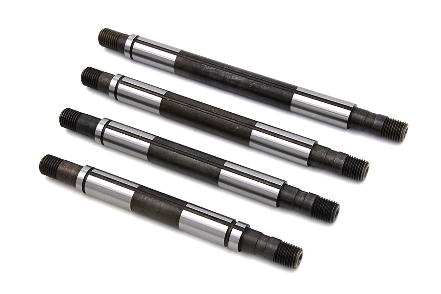

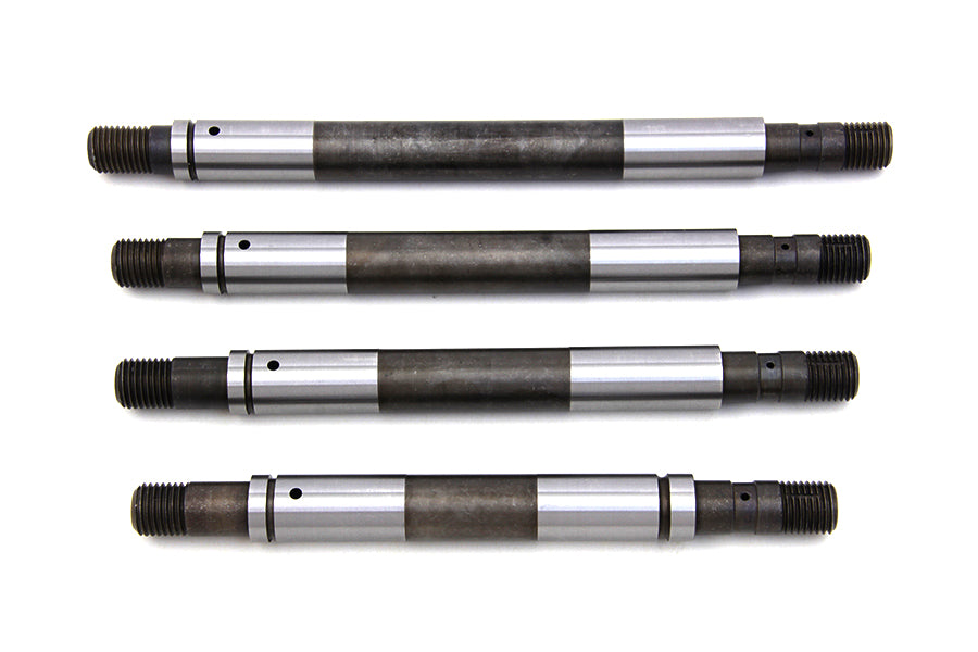

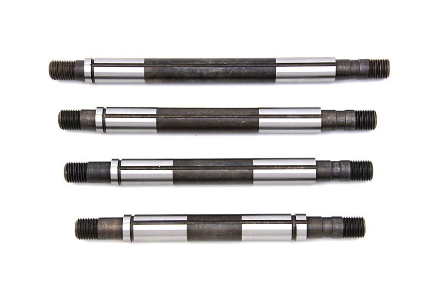

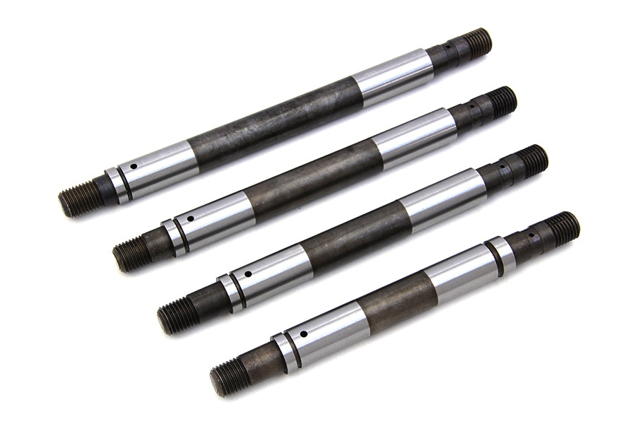

Knucklehead rocker arm shaft set features oil galley's milled into each shaft as required on the 1937 EL models with the tea cup type valve spring covers. Rocker arm shaft set is accurately reproduced after the original Knuckle motor of 1936. This set is shipped in an oil finish. Turn rocker shaft for alignment as required. This is a 4 piece set. *NOTE: Set will not accept V-Twin as rocker shaft is not threaded for the oval head screws. The bearing surface length on both ends are ground for rocker rotation. The front exhaust shaft is 5.280 inch front intake shaft is 4.095 inch rear intake shaft is 3.555 inch and the rear exhaust shaft is 4.645 inch. Fits 1936-1937 Harley Knucklehead models.
  • Suggested to use with Knucklehead Rocker Shaft Cover Kit.
  • *NOTE: Check outer diamter at the rocker shaft end on the left side installation.
