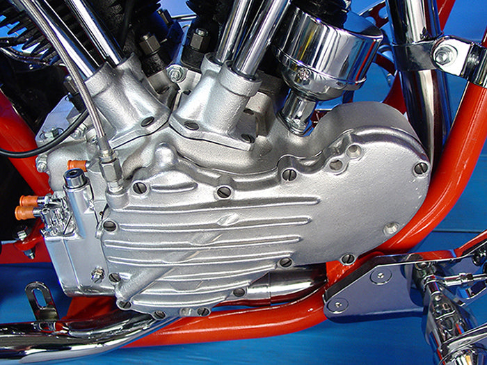

8-finned cam cover includes bushings and breather pipe with a stock die cast finish. Cam cover bushings must be checked and fitted (reamed) for final assembly. Check end play as well. Make sure oil passages and oil feed holes in bushings are clear. Tapered screw holes may require a deeper counter sink check with screw head before installation. *NOTE: Check oil passage (drilled hole) into bronze bushings either on existing bushings or when replacing bushings. Generator holes for 32E 6 volt 2 brush generators are 1/4 inch on Pre-1957 models and 5/16 inch on 1958-1969 models. Fits 1936-1947 Harley Knucklehead models.
OEM #: 25216-36, 584-36
  • *NOTE: Final reaming for fit should be completed with cover on the right side case reamed from the left side.
