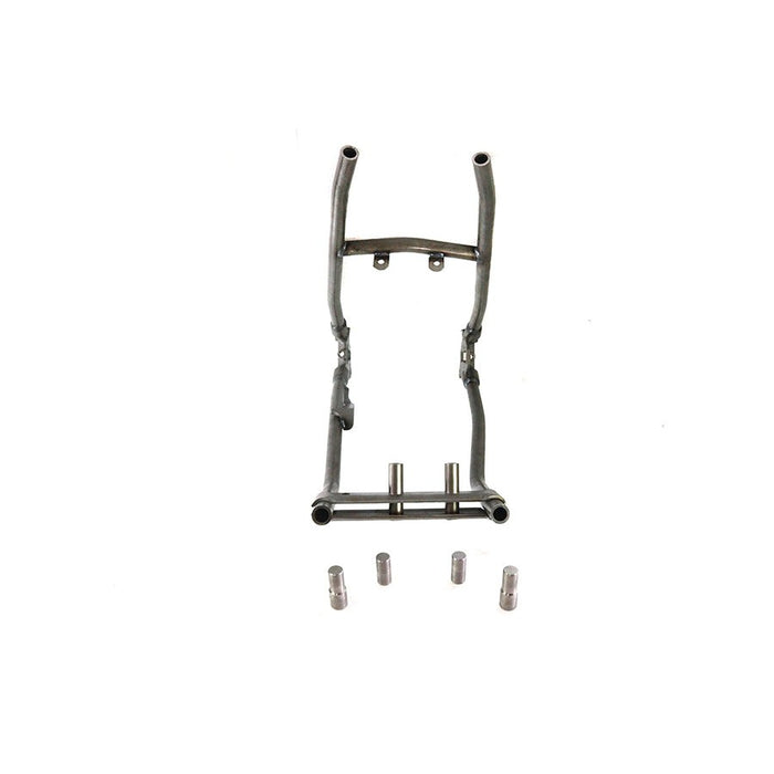

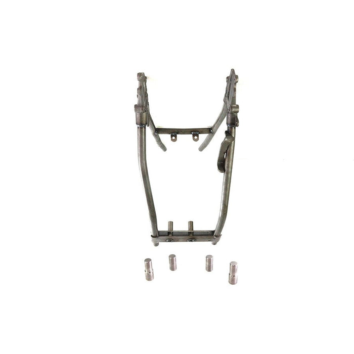

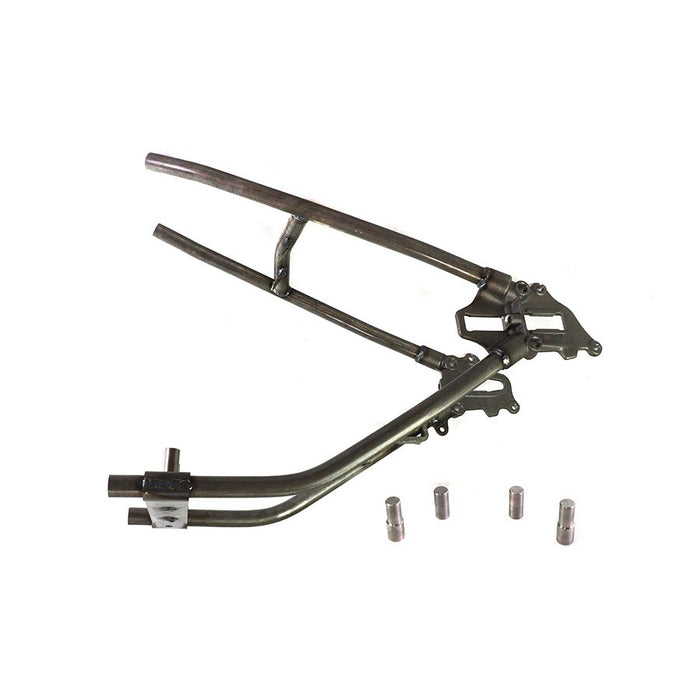

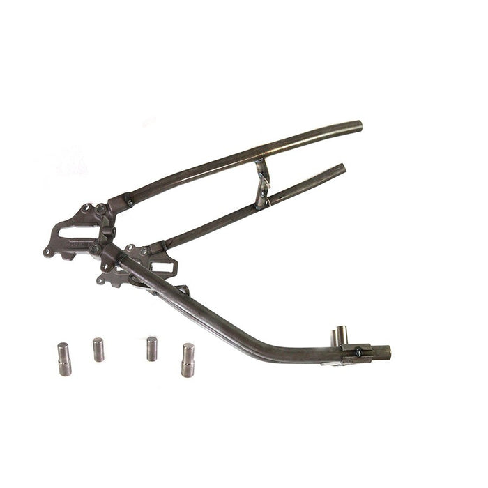

Weld on type raw steel rear rigid hardtail section features cast rear axle plates on seat post yoke for an authentic look! Accepts FXST oil tank transmission mount plate and electric start.
Use transmission mount plate and clamps as noted for mounting FXST oil tank. *NOTE: Set up for use with a 51 tooth rear pulley with 1-1/2 inch belt. Hardtail can be used with stock pulley and belt as well as 61 tooth and 70 tooth combos. Use transmission mount plate mounted in Softail frame (front) and hardtail rear bolt in place inchtight inch this is for alignment. Hardtail accepts 1987-1999 Softail rear caliper and bracket. Bracket for caliper is welded in place on the right side. Use axle sleeve spacers to allow use of 3/4 inch axle in a 7/8 inch slot on both sides. For use with a 140 size tire. 1 inch clamps suggested for rear oil tank mounting. *NOTE: Must be welded in place by an experienced fabricator! The oil tank connects to the fender cross bar. *INSTALLATION: Transmission plate and top hardtail plate with 1/4 inch holes aligns hardtail to frame. Install dowel pins top and bottom tack weld to hold in place before final welding. *NOTE: Order transmission mount plate separately.
  • Upper Tubing O.D.: 1 inches
  • Lower Tubeing O.D.: 1 inches
  • Axle Slots: 7/8 inches
  • Axle Plate Inside: Space 9.5 inches
  • Requires axle adapter spacers for 3/4inch axle installation available separately.
