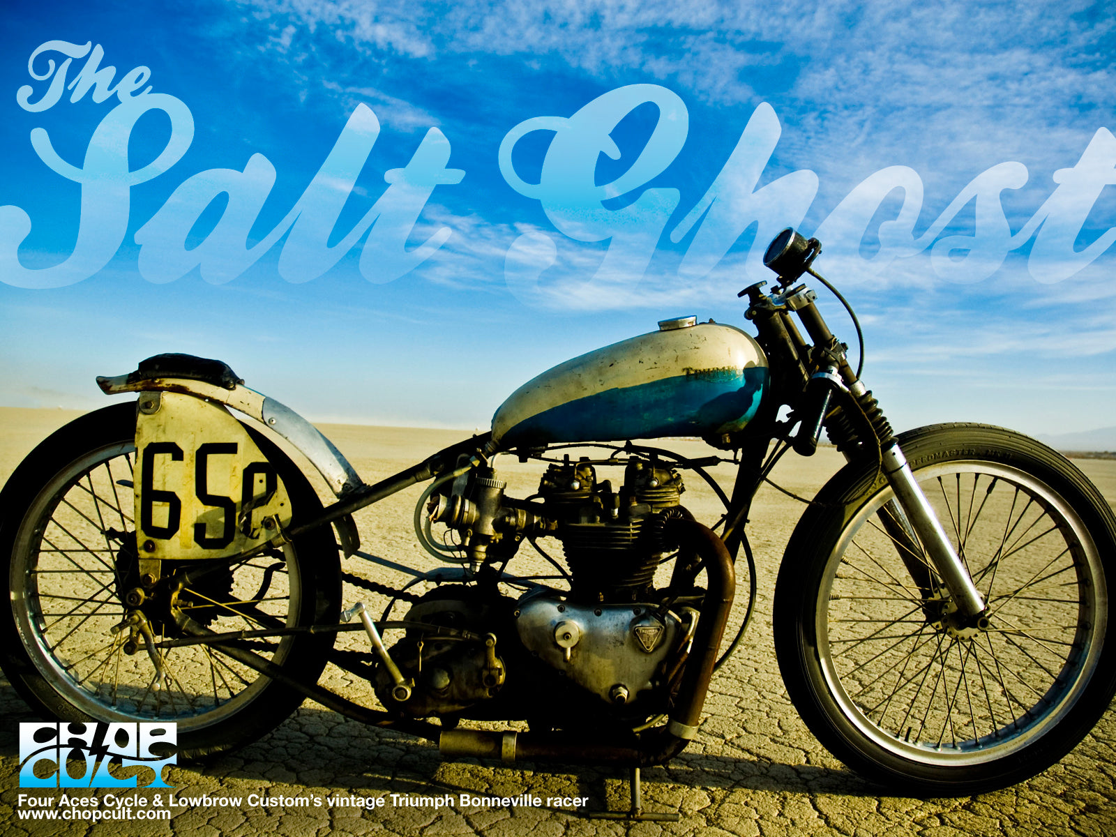

The Salt Ghost is a classic piece of dry lakes racing history, complete with badass speed parts. A 1961 Bonneville engine powers the bike, and the chassis comprises a 1948 Triumph rigid frame with a swingarm pre-unit Triumph gearbox mounted with custom alloy engine/gearbox plates. The Bonne mill has a later nine-bolt head on a 650 barrel with Harmon and Collins roller tappet conversion. The cams have yet to be identified, but they have serious lift, enough for the valves to require .008” and .010” clearances when stock was .002” and .004”.
Two Amal GP carburetors dump fuel into this fire-breathing motor through not one but two Amal Matchbox floats. These floats are like an open or shot trap door. Since GP carbs have no idle circuits, keeping the Salt Ghost lit requires revving the throttle constantly. Both the stock primary and final drive chainguards are functional works of art with just enough meat to save the rider’s foot from turning into hamburger. This open approach was necessary to facilitate speedy gear ratio changes. The oil tank is another super tricky piece that was made to fit into the place where the generator on the stock bike would have been. It probably holds a couple pints—just enough to keep the motor lubed for the three-mile stretch at Bonneville. The clip-ons are barely there, and the rearsets with no-frills brake and shifter linkage are pure function, no flair at all.
Rolling stock on the Salt Ghost is a cornucopia of goodness for vintage part nerds. The front rim is a WM1x21 Borraini Record, and the rear is a WM1x20. The front wheel is shod with an Avon Speedmaster and the rear boasts a shaved Beck “TT Special.” Shaving tread was low-buck speed mod back in the day to reduce the rolling resistance and rotational mass of a racing bike’s meats. The crowning glory for this bike is the ultra-rare 1957 Tiger 100R/R gas tank, which is distinguishable by its angled petcock fittings and its super-slim shape, to say nothing of its original, stock paint. Where is the seat you ask? It is on top of the fender, and after sitting in a barn for the past 30 years it has become a taint breaker without equal.
