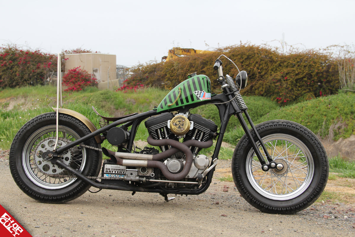

Bike Owner: Eli Wolf
Location: Oceanside, CA
Bike name: The Green Hornet / The Beast
Engine, year and make, model, modifications: 1994 Sportster XL, NRHS 1250 jugs, 10.5:1 compression, 1200 heads polished and ported to stage 3, andrews N8 cams, Mikuni HSR42 flatslide carb, Dyna 2Ki ignition, Lowbrow cloth plug wires, cut and shaved cam cover
Frame: Stock
Fork: Acme wide springer, 4" under
Chassis mods: Kansas Kustom rear section, 2" stretch
Tire/wheel size and style: 16" 40 spoke wheels front and rear wrapped with some premium Duro's
Favorite thing about this bike: Its faster than it should be
Next modification will be: no mas
Other mods, accessories, cool parts, etc: Skinny Minnie Insider Bars (Cheapskate Cycles), Foot Clutch/Hand Shift (Cheapskate Cycles), Sissy bar (Cheapskate Cycles) Heavily modded Sportster Tank (Lowbrow), Slimline Risers (Biltwell) drilled and countersunk to work with the rear springer legs, Whiskey Throttle (Biltwell), Oil Tank (Elswick Cycles), Chain Conversion, Posh grips, Brass Air Cleaner (After Hours Choppers) with engraving by Lillian Rose, Brass Ribbed Fender ( 7 Metal West) Ford tractor headlight, Side bag from Mr. Johnny Wolf and on and on
Any building or riding story or info you'd like to include: This little bike has been through more than a few versions in its time. Saved it out of shipping container years ago, dusted it off, chopped it up, welded it back together, and rode it all over this side of the country. The good ol sportsters really make for a good start to building great, reliable bike, and with a bit of figuring can really turn into a screaming animal of a scoot that can hold its own against the best of em. I wanted this thing to be short, low and fast, and it slowly came out pretty much exactly as I originally wanted it to. It was an absolute blast to build, and it's still an absolute blast to ride.
