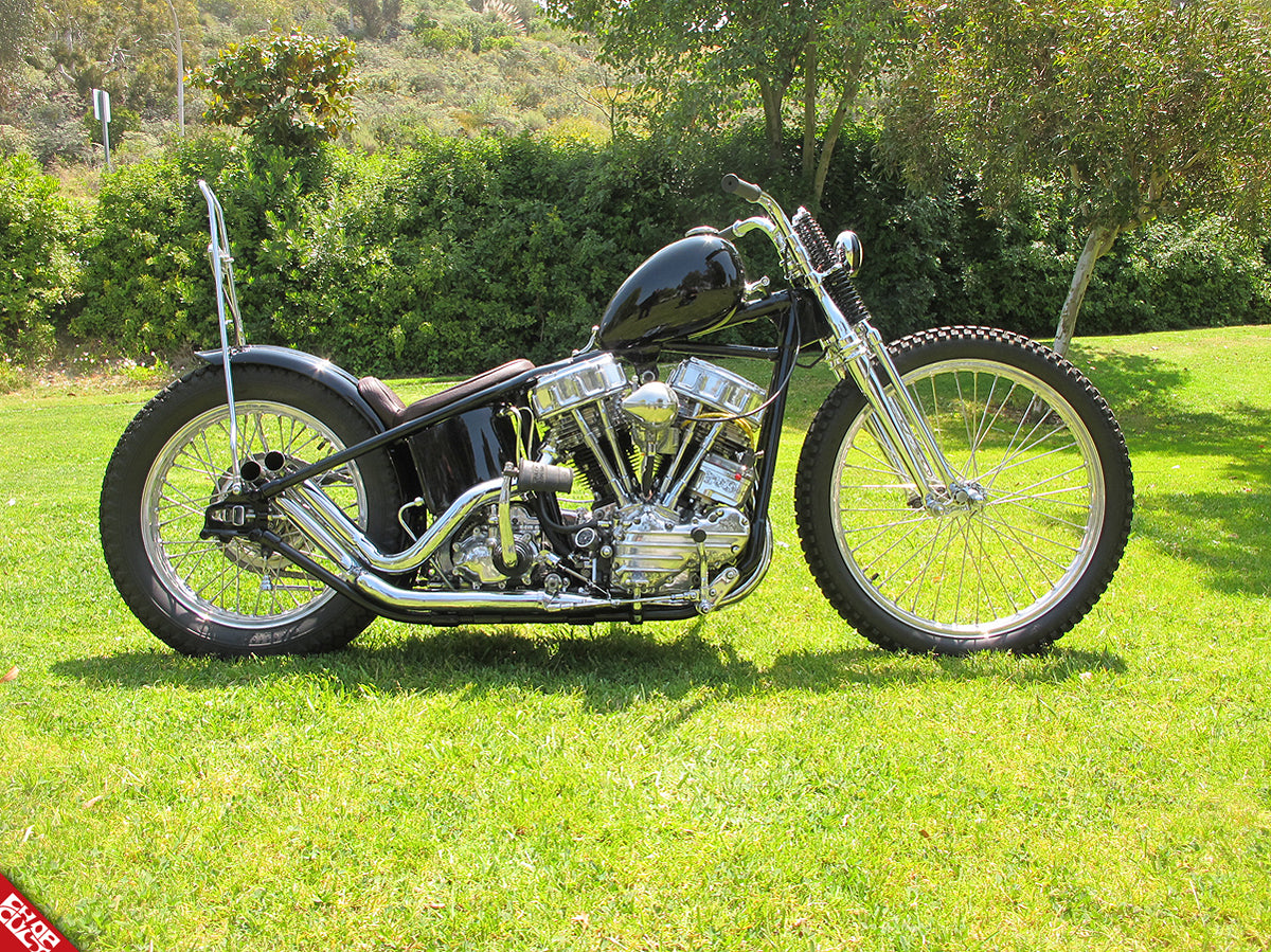

Caleb Owens can build the hell out of a motorcycle. Working out of his epic mancave, the dude has created quite a few original machines over the years, each of them built with the soul intent to ride and ride hard. This time around Caleb went the extra mile and left not a single bit unpolished, unpainted or with old chrome. Aside from the BS1 he built last year, Caleb describes this as his only attempt at a "show quality" bike. Don't take that the wrong way, this machine gets ridden. But the attention to detail and time spent make this old panhead much more than an "attempt." Quite simply, it's the real deal. The subtle details aren't as obvious as a lot of modern show bikes, and that style suits Caleb just fine. Here's Caleb's take on the direction this bike is headed…

Engine, year and make, model, modifications: 1956 Harley Davidson FL. Original cases, jugs, and heads. Original flywheels and rods. Original jugs were sleeved back to stock then honed to accept 10 over forged Wiseco pistons. NOS super B S&S carb with accelerator pump. Early Customs Cycle Engineering rocker boxes.

Frame: '56-'57 straight leg panhead frame
Fork: Narrowed Big Twin springer
Panhead motorcycle forks
Chassis mods: Frame is molded and "shaped" at castings and seat post. Springer is narrowed with shaved rockers. Tank is a Wassell that was narrowed and frisco mounted
Tire/wheel size and style: 1.85" x 18" rear Akront rim laced with stainless spokes, wrapped inside a Firestone. Front: 1.6" x 23" 36-spoke front aluminum speedway rim laced with stainless spokes to an early chopper hub

Other mods, accessories, cool parts, etc: Anything that could be hand-made was hand-made. The foundation for most parts was a stock part that was heavily modified. Engraving on rocker tops, cam cover, magneto, carb, kicker cover, all in traditional scroll patterns done by Mark Cooper. Taillight is a 1948 microphone from a home reel-to-reel recording device. Carb cover is '40s era Ice-O-Mat ice crusher top, polished and engraved. Shifter knob is a hand-turned piece of walnut glazed with photo of my Dad circa 1945'ish. Paint has hand-made scroll designs etched in the clear coat. Mr. Cro was etched in the chrome on the clutch cover
